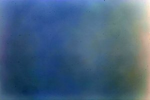

I showed them a CR2 file with all the dust, which was taken days after I got my camera back after modification. All dust particles on that photo perfectly allign with the test picture taken by the cleaning comany after cleaning. This company has cleaned over 50,000 cameras and manages to get every camera completely clean. He also modified a 600D for IR in the past, but I sold it because I wanted fullframe IR.
