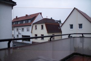

I put the camera on i tripod and did the shot with speedbooster and with regular adapter. It's not realy focus to infinity but more than 10 meter. Then i tried to match both pictures in Photoshop. As you can see i moved the camera between the shots :) Scaling is 70.5% so the x0.71 is confirmed. I used manual exposure set to 1.2/1.8 and 1/2000 / 1/1000. The shot with regular adapter seems a bit darker so i guess the boost is even a little more than one stop.

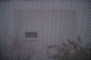

This time the fence on my balcony. I tried to place the camera at right angle to the fence but not scientifically. It was only about 70cm away from the camera and matching both images resulted in a little less than 70% and again a little darker. As you can see the 28/1.8 isn't exactly sharp in the corners even without booster and even on a crop camera. But there is enough usable area in the center of the image even with booster. The CAs are easily removed in LR.

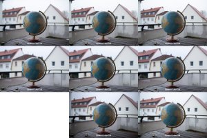

The prime reason for me to go FF would be to have more focus separation. I used a globe to simulate a portrait and tried to frame it the same size with all focal lenght. I invited the EF-M 22/2.0 to the party as it's very close to the 28mm with SB.
