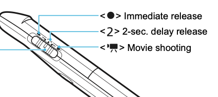

Try starting/stopping the R5C with it in video mode.
No, thanks…since 1) I don’t have an R5C, 2) I don't shoot video with my ILCs (I have a Canon HF G60 for that and it has a dedicated remote), and 3) when I shoot video with my PowerShot V1 as I do occasionally, the BR-E1 starts and stops video recording just fine, even if I didn't switch the camera to video...just need to set the BR-E1 to start recording.
Sorry that doesn't seem to work with your R5C, but it's not the remote's fault. I haven't tried using the BR-E1 to start video recording on my ILCs for the aforementioned reason #2.
