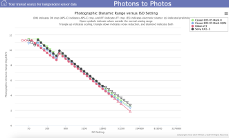

The DR of the R5ii at iso 100 is 11.5 with EFCS, and 11 in ES, compared with 11 for the 5Div and 9 for the 5Diii. As if the loss of 0.5 "defeats the entire purpose", and as shown by photonstophotos there's little difference between it in ES mode and the Sony A1 and the Nikon Z9,.
