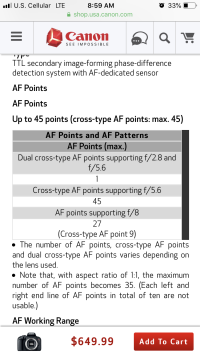

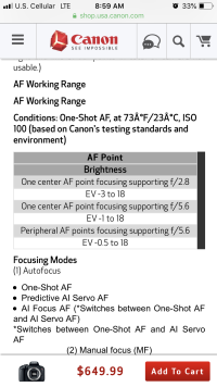

I can appreciate that but I think the obvious answer is comparing a dual processor camera that costs three times more with a f2.8 telephoto lens vs an f4. The EV-5 spec on the R isn’t the only factor here in this situation.
What would you expect comparing a 5D4 with the 70-200 vs a T7i and Kit lens? 184579184580
Here’s the specs from a t7i. I wouldn’t expect it to perform as well as the 5D in the above example in the real world EV-3 isn’t the only spec that’s different.
