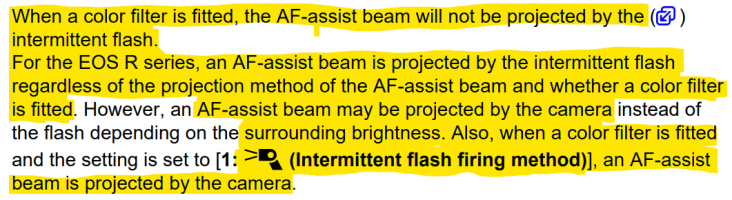

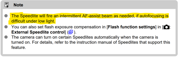

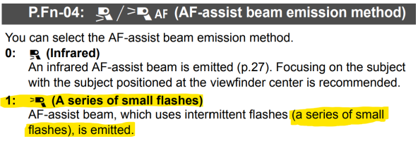

The manual says AF Assist Beam emission method is dependent on the ambient lighting. When my friend was testing the speedlite with the RF 24-105mm STM lens. The camera tried emitting the body lamp first. When it couldn't lock focus the camera sent the AF Assist Beam signal to the speedlite instead. Cameras released from 2007 ownward support the speedlite control menu. These cameras also allow the use of Intermittent Flash Firing or an LED AF Assist Beam. Now I'm not sure if these cameras can vary the voltage to the speedlite to provide a brighter pre-fire/ pre-flash for the AF Assist Beam. In dimly lit situations the speedlite would emit less pre-flashing and it also looks dimmer. But once we went into a darkroom the speedlite would emit brighter pre-flashing and it was more frequent. Pre-2007 cameras only support the IR AF Assist Beam. If you try using a speedlite set to Intermittent Flash Firing on these cameras the speedlite WILL NOT emit an AF Assist Beam at all. Speedlites equipped with a personal function for both IR & Intermittent Flash Firing also add a special feature for an R series camera. If the speedlite is set to Intermittent Flash Firing and a color filter or a flash diffuser is attached to the speedlite. The camera will emit the AF Assist Beam instead of the speedlite. Since Intermittent Flash Firing is disabled with a color filter or a diffuser attached. Also when these speedlites are set to IR the AF Assist Beam will emitted by Intermittent Flash Firing. When used on an EOS R series camera. Intermittent Flash Firing is NOT compatible on EOS M series cameras. The 320EX is the ONLY speedlite that will provide and AF Assist Beam on an EOS M series camera via an LED lamp.
