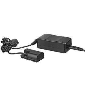

These things work if you have access to an outlet, there are much cheaper ones than this btw.
**LINK**
Thanks, so you think Canon intentionally gimped the camera not to work via the USB so they could sell an extra accessory for $200 CDN?
