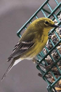

What do you think of the sharpness I got on this top one, center cropped to 100%, ISO 1000, on a digital crop camera built by the ancient Sumerians before the last ice age ended.
I know the focus is a bit off on the eye, but the tail and wings are sharper. I just snapped this handheld on a zoom lens at 200mm with no IS, wide open at f/4.
Please do not criticize the composition of the finch, I know it's lame to shoot birds on feeders! I'm the opposite of a bird expert!! And obviously I don't know when to go outside, it's always getting dark! I'm just showing this one because I recently shot it and tweaked it this evening.

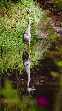

Below it is a heron image I submitted to a magazine's website about two years ago. It's also handheld with no IS, with a 135 f/2 + 2.0x ii TC, scaled down a bit.

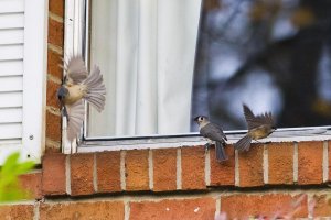

The bottom was shot with a 1D4 and 300 mm f/4 IS, at ISO 6400, fall 2012.
