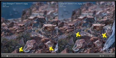

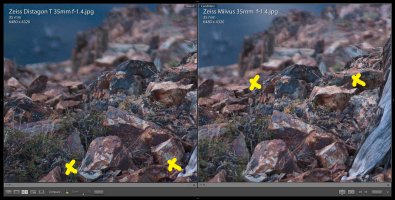

I don't agree with your assessment. To me the Milvus looks to smoothest. You should note that the focus is different in the images so the softness in certain parts of the image is going to be misleading.
(See these crops where I've marked the plane-of-focus with yellow.)
You'll see that the Distagon is more front focused than the other lenses so foliage will appear softer, but if the other lenses were focused identically then they would blur the mid-ground and background more so the result will be different.
Personally I like the Distagon and 35L-II from a 3D-rendering perspective. (The Distagon has LoCA while the Canon is neutral) As I seriously dislike longitudinal chromatic aberration my overall preference is for the 35L-II but I can see why people might opt for the Distagon for it's chroma halos, or the Milvus for the smoother out of focus areas.
Tangent: The Canon appears much sharper at f/1.4 but as noted previously the Milvus is focused further back...
