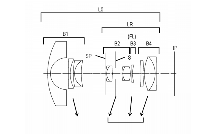

    An optical formula patent application for an 8-15mm fisheye zoom lens has appeared at the USPTO.
    The patent covers both the APS-C (EF-M) and full-frame (RF) mirrorless mounts as the backfocus for each embodiment is well shorter than the EF's 44mm.
    APS-C embodiment:
    Focal length: 5.30mm  – 9.51mm
    F-number: 3.50   3.50
    Angle of view: 181.00° 182.00°
    Image height: 7.50mm  13.50mm
    Total lens length: 77.28mm  – 69.52mm
    BF: 11.09mm  16.77mm
    Full-frame embodiment:
    Focal length: 8.01mm  15.30mm
    F-number: 3.78   4.60
    Angle of view: 177.30° – 183.10°
    Image height: 11.15mm  21.64mm
    Total lens length: 105.23mm – 103.57mm
    BF: 12.00mm  28.46mm
