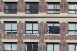

    Here are two images at 14mm, same scene, both 100% crops from the extreme corner. One is from a lens that has essentially zero geometric distortion at 14mm, and no distortion correction was applied. The other is from a lens that has serious barrel distortion to the point of black corners at 14mm, and thus requires 'stretching' to fill the frame. Based on your statement that stretching is bad, it should be obvious which is which. Is it?
