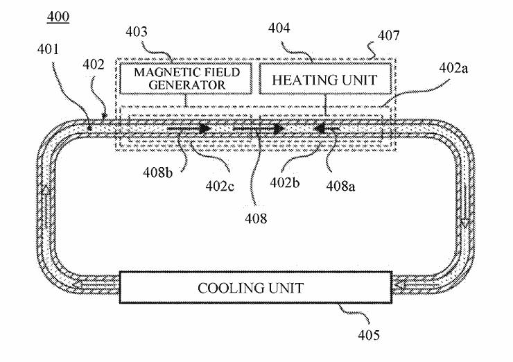

Keith over at Northlight Images uncovered a pretty cool patent pertaining to cooling of camera bodies. A lot has been discussed about this topic over the last couple of years.

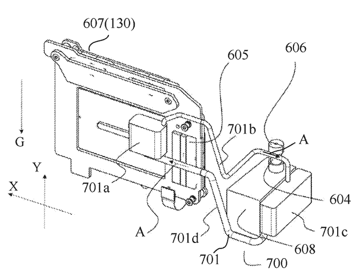

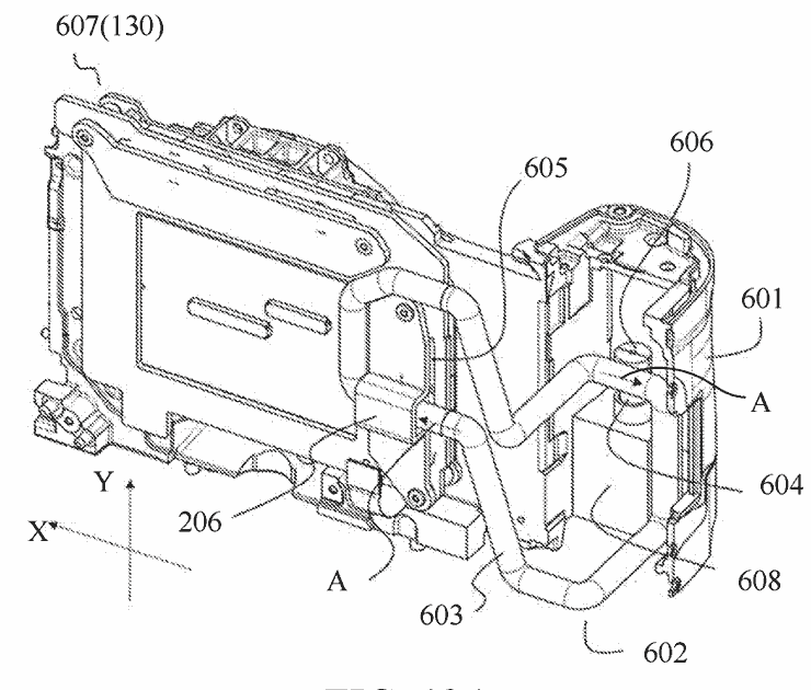

This patent shows Canon using magnets to pump the liquid through the cooling tubes, which I would think, would make this type of active cooling silient, unlike internal cooling fans. This would also do a much better job of bringing the internal temperatures down that simply using copper heatsinks.

  5. I wonder how robust these active cooling systems will be. A copper heatsink is passive and in theory can last a decade. I am not so certain on an active cooling system. Personally, I hope the R1 does NOT have an active cooling system. Maybe this cooling system will be reserved for Cinema series?

    I don't think so. It states that magnets are used to move the liquid through the tubes. I'd imagine these to be permanent magnets, rather that an electromagnetic design. Neodymium magnets, maybe? It could be that the liquid viscosity changes in the hotter part of the loop too, which might influence the liquid in the magnetic field. *Just me making an uninformed guess. I've forgotten a large part of my physics and magnetism training.* Again, just my guess.
  7. I don't think so. It states that magnets are used to move the liquid through the tubes. I'd imagine these to be permanent magnets, rather that an electromagnetic design. Neodymium magnets, maybe? It could be that the liquid viscosity changes in the hotter part of the loop too, which might influence the liquid in the magnetic field. *Just me making an uninformed guess. I've forgotten a large part of my physics and magnetism training.* Again, just my guess.
    That sounds like the "Magneto-Hydrodynamic" drive from the Red October :)
  8. Honestly, I don't think liquid cooling is the best solution in an application like this.
    Vapor pipes might be more useful in this application, because these don't require moving parts and as far as I remember, they can actually transfer more heat than pumped liquid cooling.
    Vapor pipes are also a fully passive cooling solution, so they won't impact battery life.

  10. I dont think that is depicting liquid cooling, I think those are heat pipes. True liquid cooling wouldnt make any sense from a cost, reliability, and performance aspect. Small heatpipes and heatsink fins are already widely used in cameras.
