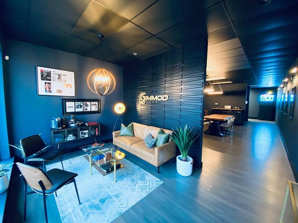

From small beginnings Simmod has rapidly grown into the world’s best known and most trusted lens cine-modding company. In recent months it has invested heavily in new R&D, machinery and premises that allow for precision work at larger scale. The remanufactured rear element for the FD 85mm f1.2 L is the first development of many to be launched in the coming months.
The new Simmod Lens facility
