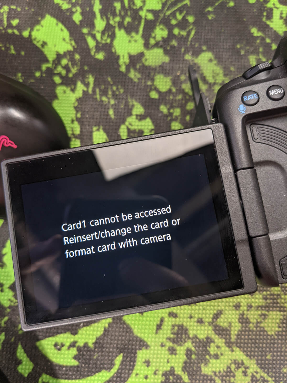

It came to my attention today that there appear to be compatibility issues with the latest Canon EOS R5 firmware and Exascend CFexpress memory cards.

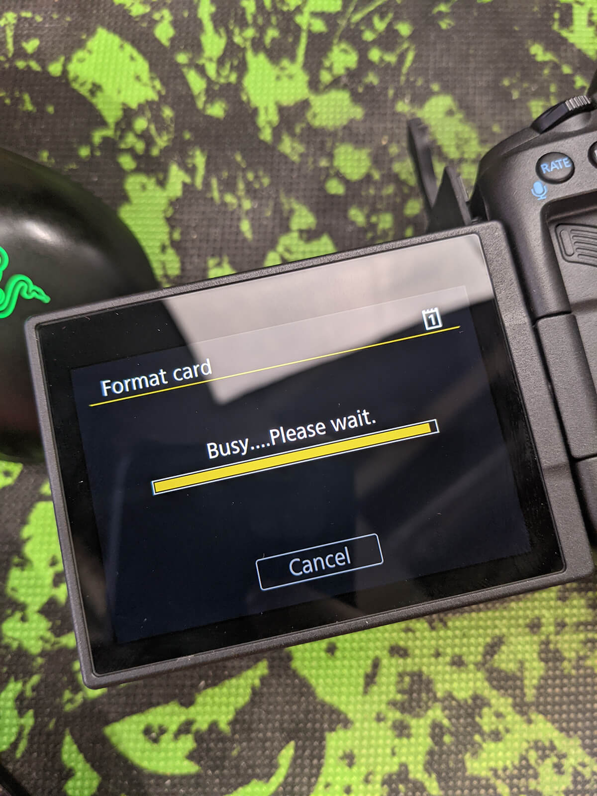

Shooters with a Canon EOS R5 and firmware v1.4.0 are getting camera lockups when attempting to format the memory card in the Canon EOS R5.
Images courtesy of Highigan via Discord
From Exascend
Some Canon EOS R5 users have reported problems using their Exascend Essential CFexpress after updating their camera system to firmware version 1.4.0.
If you are experiencing similar problems, please contact the store or online retailer where you bought the product to proceed with a firmware upgrade of your Exascend Essential CFexpress card that ensures continued compatibility with the Canon EOS R5 system.
The solution offered by Exascend doesn't appear all that helpful, I'm not sure how Amazon is going to help owners with a firmware update for the memory card.
I have reached out to Exascend for further clarification

    This is likely a knock on bug from - "Adds support for the VPG 400 (Video Performance Guarantee Profile), a standard based on the CFexpress 2.0 specification." in 1.4.0.
    I would not be surprised if Exascend missed something in the CFexpress 2.0 protocol that was not an issue until VPG 400 was enabled on the R5. I see this all the time with the Onvif protocol and manufacturers cutting corners.
