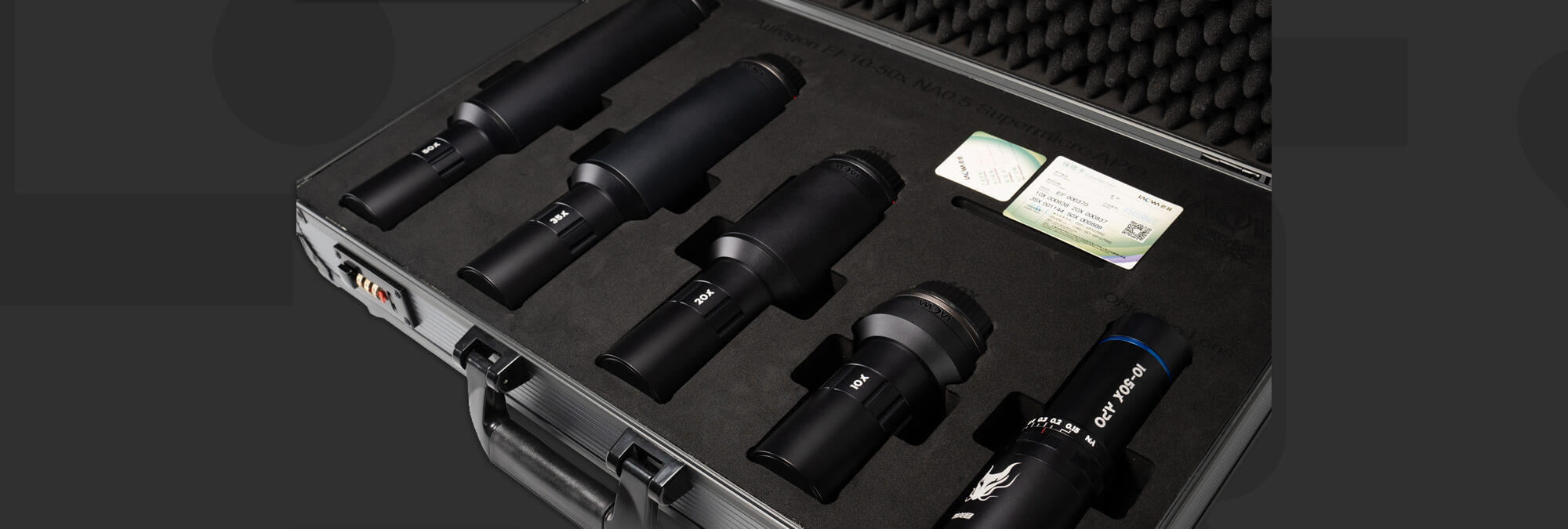

With a modular design, the lens has a universal objective lens and can easily switch between four magnifications with a different tube lens.

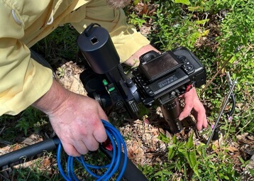

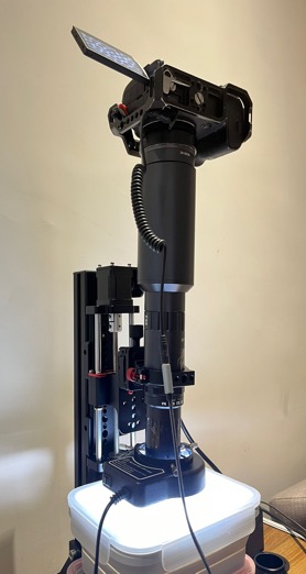

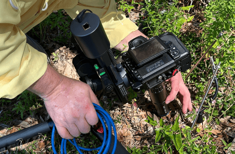

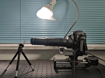

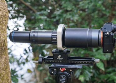

The Aurogon design makes setting up the lens easier than ever. Whether using a 10X or 20X in the field, or 50X in a studio setup, you can easily adapt your own setup preference to get the best of it.

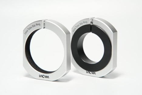

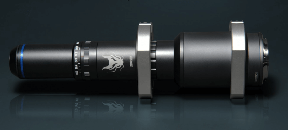

Additional Lens Tube Slip Ring

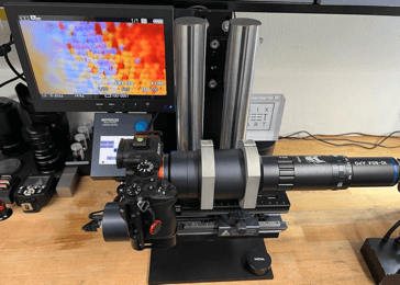

For those who are looking for a made-ready setup to attach the lens for stable shooting, Laowa offers an add-on option of a Tube Lens Slip Ring set. It can be purchased separately on their website.
The set of tube clip rings comes with 2 rings. One for attaching the objective lens and one for the longer barrels of higher magnifications. You may also remove the inner ring of the front ring to use it on the tube lens. The position of the rings can be adjusted depending on different setups.
![]() | You may even use it to attach a rail platform at the front. Moving the subject instead of the whole system also helps to reduce vibration for a simpler setup. |
