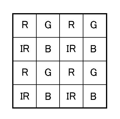

The sensor itself would end up having a different color filter array from the standard Bayer format, looking something like;

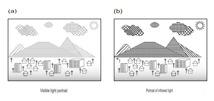

Canon describes that the system would take an image of color and then follow up with the image using the IR pixels, leading to something like this:
image 13 728x344 - Canon Patent Application: Hybrid IR/Color sensor to improve Image Quality
Canon would then combine these images and use the infrared light image to further refine the color video. Canon specifically mentions that this patent application that this application can be applied to stills and video.
