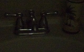

This appears to be a very low light/low contrast issue. I took my 1DX in Ai Servo, 4 point expansion into my bathroom with the door closed and window blocked as to only allow in the smallest amount of light (simulating moonlight conditions at -2ev). There I attempted to focus in Ai Servo as if I was trying to lock onto a subject in low light that needed tracking. In my test I was actually very impressed with my 1DX. I shot this static image with my 50mm F/1.2 at 1/2000, F/1.2 and ISO 51,200. I kept the shutter speed high to simulate the speed I use to stop action even in low light. The camera was able to lock focus on the high contrast and shiny sink however if I tried to lock focus on either the soap bottle or lotion bottle which flanked the sink it failed no matter the distance from the subjects. I put it in L and H shooting speeds and this made no difference for me. All in all I am pleased with this cameras low light focus and tracking ability as it has been put to use in some local band gigs around the Seattle area with fantastic results.
For information purposes my 1DX serial is 042XXXXXXX31.

The focusing limitations previously were related to low contrast in AI Servo with a subject that is not changing distance, and not necessarily a low light issue, although that doesn't help the situation.
Hi Richard, Thanks for replying :)
The original issue was the Ai Servo and contrast in low light - correct, there is a definite discrepancy between ai-servo and one shot ability to focus on objects in low light - but the reason for it being an major issue (to me anyway) is you can't track what you can't lock onto initially: if the lens doesn't rack or the lens racks to infinity and stops when trying lock onto an object - stationary or otherwise - then you can't track that object to start with. Example - this initial became apparent when trying to track my cousin moving around the house, with a fair amount of house lights on.
My camera exhibits this issue in lighting conditions that it should have no issue in (the 7D for example locks regardless) - same as justaphotographer and the in-store demo unit. However that inability to lock onto the target isn't noticed when enabling 10 fps or lower, there is no issue with re-racking the lens and the af points move over the object at a noticeably higher rate then at 12 fps.
I do apologise for the confusion - I hope this is a little clearer.
