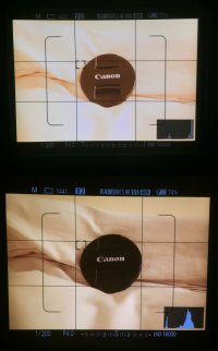

Here you go: Based on your understanding and that table you seem so fond of, which of these files would you expect to have more noise? Or do you expect they contain the same amount?
