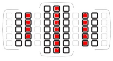

strange, i found my yongnuo very effective for af assist in a dark room (I did have to align the head slightly with the AF points first though the verticle lines provided very snappy AF to the points i have coloured in red on the attached image
