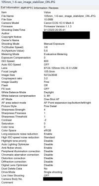

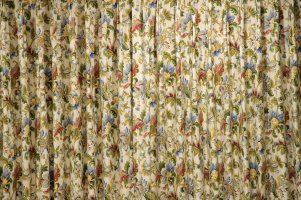

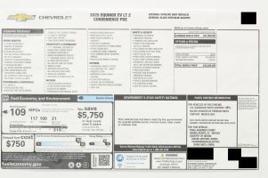

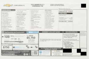

Anyone out there has IS issues when mounted on a tripod?
Way back, the white L telephoto lenses with IS, when mounted on a tripod with IS enabled, ‘oscillated’ as the IS sensor would be in a ‘dead zone’ with no movement detected. This was fixed in latter versions of these lenses.
Recently, on an indoor existing light tripod setup, I had an issue with IS on with my EF 100mm f/2.8 L Macro lens. I used mirror lock and self-timer on my 1DX II. Stopping down several stops from wide open (with correspondingly longer exposure times) yielded decidedly increased blur – way more than diffraction effects. I thought perhaps some minor vibration in my floor was causing the increased blur with longer exposure times. I always walk away from the tripod during the 10-second self-timer countdown. Experimenting with turning off the mirror lock, self-timer and IS determined IS was the culprit.
Perhaps the EF L Macro lens’ ‘hybrid’ IS does not like to be mounted on a tripod?
Most lenses with IS should have it turned off when using a tripod. Newer lenses detect tripod mounting (based on a lack of motion) and disable IS. I don’t know how that works with adapted lenses on R bodies, and I don’t think the IS system on the EF 100L Macro is tripod-sensing anyway.
As a general rule, IS should be turned off when on a tripod. The exception is with Canon’s supertele lenses depending on the model, e.g. the IS system of the 300/400/500/600 MkII and the MkIIIs of the the 400/600 lenses can mitigate mirror slap on a DSLR.
