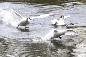

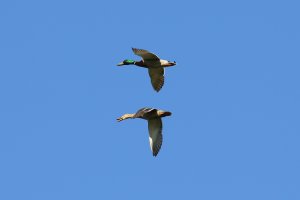

Here are mine... I'm feeling pretty good about the AF now, but in my first couple shoots trying different AF settings I, like you, was a little disappointed. But after spending some time playing around with AF settings I've come to a point where I think the AF is great...maybe not excellent, but great.
I've added a couple shots where the AF was challenged...I shot both of these images w/ the 70-200 ii with 2xiii (which obviously slows down AF speed)
the ducks were really flying fast as they were flying downwind
the trumpeter swans were moving quickly and a bit erratic (they were fighting)
both groups of birds were about 150 feet away - I think the autofocus nailed these shots
both shots - HANDHELD

Really nice shots! Could you please share what your AF settings were e.g. Case 1 through 5 in the AF menu and if you did any further adjustments after selecting a Case.
Thanks.
