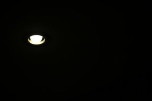

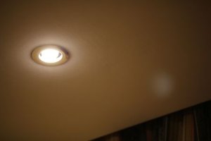

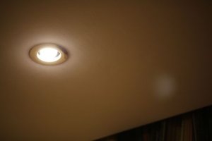

Update: see the 4 pics attached, made with 135 f/2 L
the AF point is on the light on ceiling, iso is 320 fixed, aperture f/2.0 fixed
pic 1 has AF + eval metering, resulting in 1/4000 sec (strong bias on the AF point, it results effectively in a spot metering on the AF point)
pic 2 has MF + eval metering, resulting in 1/160 sec (the camera has no clue about the AF point in use, and provides a "true" unbiased evaluative metering)
pic 3 has AF + mean metering, resulting in 1/160 sec (no bias on mean metering)

As you see, in the case AF + evaluative metering the camera attemped not to clip the area of the picture on the selected AF point, thus rendering every other area of the image absolutely meaningless.
The amount of shift in this case is almost 5 stops!
If I were the designer of this feature, I would let the user to activare or deactivate it, or at least provide a "cap" on the maximum amount of correction allowable, say max 2 stops of bias.
Having it permanently operating as it is, without reasonable cap, means that you have a spot metering on whatever AF point is selected, and this is pretty disturbing to me in certain circumstances.
