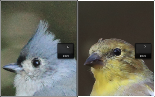

5dIII vs 7D shoot out for bird photography at 600mm and cropping
Misunderstandings always build up in threads because people come in at the end without reading the earlier posts. All of these images are for quick comparisons done under the normal conditions I, and many others, would use for amateur bird photography. The results are of use to me and for some others who may be similarly wondering whether to keep their 7D now they have a 5DIII or whether they should sell their old 7D to buy a new camera. The conditions are not what the perfect ones that TDP etc use for a scientific comparisons, but sub-optimal conditions used in every day life.
1. The title says exactly what is going on – cropped images for bird photography at 600mm for a 5DIII vs 7D. It is not a scientific survey of FF vs crop under all conditions for all lenses and all bodies. The 7D is not a representative of all crop cameras. Its sharpness will depend on the sensor’s characteristics - for example its AA filter. The comparison is done for heavy crops from both systems to the same size, not for landscapes etc.
2. I said at the beginning that the photos were not very good. These photos are for comparison purposes under the same set of conditions, not choosing the best photos taken on a particular camera under optimal conditions. They are not the highly selected best ones taken, of which one is proud - I have plenty of fine keepers from both cameras. So no snide comments please about how you would have discarded them immediately.
3. Regarding focus problems. The lenses have all been AFMA-ed with the bodies using both Focal and sloping ruler tests. There are issues with the AF of the 7D – many posters find that it is erratic. Motion blur is unlikely – the one of the grey (not blue) heron is representative of a group of shots that were all similar, taken at 1/1250 s and 4 stops of IS, with the camera still and resting on a ledge.
If I want to take a photo of the moon, then my 600mm on my 7D with a good tripod etc will out-resolve the same lens on my 5DIII. But, what I wanted to know the answer for is how much of the advantage of crop on the 7D is realised in 90% of what I take. The answer is that the 5DIII is better. But, the situation might change with a 7DII. And then a 5DIIII might reverse it.

That exactly is the point ... isn't it? To see the IQ differences in both cameras, you need to test the limits to see which one does better.
Shoot the same subject in good light at ISO 100 and I very much doubt whether you will see much difference between FF and an(y) APS-C. It's only when the lighting gets a bit murky that the 5D3 pulls away.
Thanks for posting Alan. I am one of the people in a similar boat. I ran my own tests, not quite as good as yours and ultimately concluded that cropping the 5DIII was good enough compared to the 7D.
Both are excellent cameras. But as a hobbyist, I haven't yet found justification for keeping two dSLRs. I am in the process of selling my 7D. My "body kit" will be the 5DIII and EOS-M.

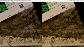

I have a 7D and a 1D4. My findings: Without much cropping the IQ from 1D4 is better, of course. However, in reach limited situations where heavy cropping is needed, I find 7D to give better IQ up to about 3200 iso. After that 1D4 gives more details and less noise.
Here is a comparison I did:
Test setup:
7D+300mm+2xtc @ f6.3 vs 1D4+300mm+2xtc @f6.3
Distance to target about 30 feet, Live view AF, 10 sec time delay, Raw, ACR, No NR.
7D image resampled down to 1D4 resolution.
100% crops.
iso 1600. (Could'nt post iso 800 and iso 3200 due to size limit..., if anyone interested I can post separately)
1D4 left, 7D right
