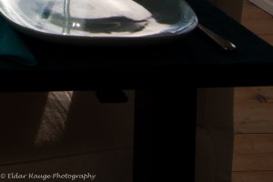

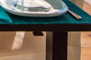

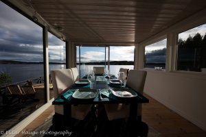

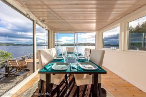

It might be that people don´t think to much about how much a stop or two is. So here is an example.
To me this is at the extreme end of what I do. I have done more extremes than this, but I believe it is a good example.
First the straight RAW-file, just levelled, then the finished image, then two crops from each. If this was a more important picture, I would have worked more on the noise reduction, but that is a bit beside the point here.
The finished picture is Exposure: +1.5, Highlights: -100, Shadows: +100, Whites: +55. Colour luminance (blue): -34 and some rudimentary noise reduction. There´s a Looong way to 6 stop.

I have never seen how much compensation +100 shadow lift represents. So I played around with a couple of images. It seems to me that it represent around 2.0 to 2.5 stops. Does anyone have more presise info to share?
If what I found is correct, the shadows in the image above is lifted 4-4.5 stops (which was more than I thought).
