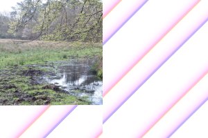

I have similar corrupted files - Canon 7D Mark2 and sandisk sd cards
All files OK when viewed in camera from both SD and CF cards
Sandisk 16 gb and 32 gb card have many corrupted files when connected to USB2 card reader (tried 2 different inexpensive USB 2 card readers)and viewed in Bridge - Same files are corrupted on each card - even when disconnected and reconnected several times
Sandisk 8 gb card ok when viewed in bridge with both card readers
All images can be transferred to Sanho Colorspace and from there to Bridge without any corruption
Is it possible that cheaper card readers tend to corrupt data on larger SD cards?

I have had the exact same problem of corrupted files upon import via LR5 from Lexar 32gb CF UDMA cards, even though the files are fine in camera (7Dii). I used a Lexar 3.0 card reader as well as importing directly from camera. Lexar has already replaced two cards, and it just happened again. The same strange color banding.

I've used a lexar and verbatim card reader and I'm still getting corrupt images (same as those posted) from it
There seems to be my rhyme or reason for this at all, the SD is fine but the lexar card is causing issues

I've also problems with corrupted RAW-images.
Sometimes (rarely) it appears.
The only CF card (which I used most) which giving troubles is the Lexar 32GB 800x UDMA7.
I have replaced it by a new one (garanty) but the problems still remain. Recently my camera was send back for repair, but the problems will still remain, even with a new mainboard.
I've tried al solutions mentioned above, but none helps.
My opinion is that this specific Lexar card won't work correct with the 7D mkII.

My Lexar 64gb 800x has had two corrupt raw files since I bought it. But that is 2 out of about 20,000 clicks so I'm really not complaining. I don't think it's worth replacing the card because of two files.
I almost forgot to add. The two files looked exactly like the one posted.
