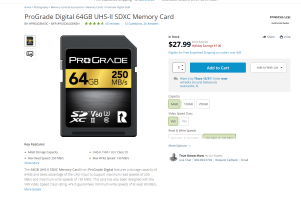

Do you often switch back and forth from video to stills? I'm finding the Sandisk and Lexar version I's work fine for stills.
ONE OF THESE DAYS SOON will try video. :rolleyes:
And this one is working great too. But still haven't tried video.
