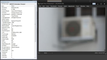

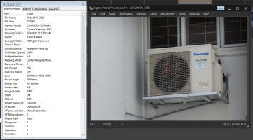

Hi,
My 7D2 AF work most of the time, but there are some situation that the AF will miss focus.
After some testing, I realized when AF subject with repeatably lines with certain spacing on it (not those test chart when the lines are very close together), the AF will think that it's in focus, but actually not... even in one-shot.
I perform the same test on my older 60D and although it'll also struggle to focus, but only will miss once in awhile... not as regularly as 7D2.
Have a nice day.
That's not a defect, that's a normal limitation of the way phase detection works - if there are adjacent similar contrast curves (remember the AF sensor doesn't see a picture, it only sees a single line out of this) then the calculated focus position may be calculated on the bases of two different elements of that grid - and thus be grossly off. No service and no algorithm improvement can remedy this. It is also listed under the topic of possible AF failure conditions in the manual.

Hi,
I saw that in the manual, but I didn't expect it'll report "achieve focus" (AF beep sound) in One-Shot AF or stop hunting in AI Servo AF... my expectation of AF fail to achieve focus is that it'll keep hunting in AI-Servo or unable to report "achieve focus" in One-Shot... learn something today. ;D
Have a nice day.
