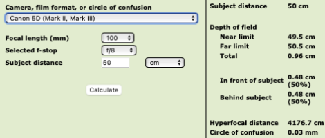

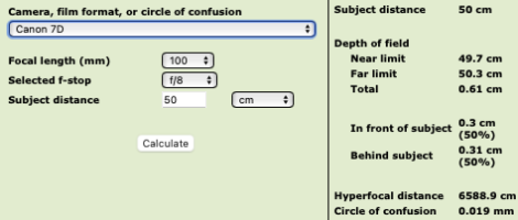

DoF calculators take CoC into account for their calculations. Here's an example from one such calculator, a shot at 100mm f/4 with a subject distance of 50 cm. If you change only the sensor size, you see that the FF sensor has a deeper DoF than the APS-C sensor, because the smaller sensor has a smaller CoC, so the resulting image must be enlarged more for final viewing (again, for comparison purposes we assume a fixed output size and viewing distance).
Screen Shot 2021-10-05 at 1.44.31 PM.pngScreen Shot 2021-10-05 at 1.44.37 PM.png

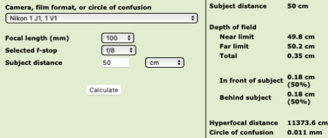

If you pick an even smaller sensor, like the 1" sensor in the Nikon 1, the DoF gets even shallower, because a deeper crop means even greater enlargement is needed.
View attachment 200621View attachment 200622

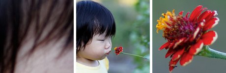

Oh boy! We've been through this so many times. I'd like to know what, other than lens aperture, distance to subject and focal length of the lens, is going to affect depth of field? Real depth of field, not perception of depth of field.
In this example the depth of field does not change.
Here's an example where the hair and flower appear in focus at small viewing size, but in reality only the flower is in focus. The reduction in size of the full image increased the DoF because it changed the perceived sharpness of the image. The same is true in reverse – enlarging an image results in a shallower DoF.
What changes is, as the image is enlarged, it is easier for the eye to perceive the lack of focus. The reverse is true as well, the smaller the image size the sharper the image is going to appear to the human eye. But, the actual depth of field never changes, it's simply that the larger the image, the easier it is for the human eye to see that an object is not in focus. And, yes, viewing distance will make a difference in perceived depth of field. A billboard viewed from the street may appear sharp, but when viewed from three feet away, any lack of sharpness will become apparent. Depth of field doesn't magically change, it is simply a limitation of our own biology.
