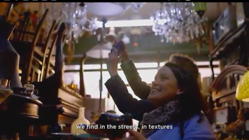

I think the clip might be edited and the view being showing on the LCD is not from either of the cameras the man and woman are using. Its from the cameraman who is filming them both.
You can see the lens the are both supposedly using in the clip at 2:15 onwards as they show each of them taking photos of each other, with the LCD showing F1.4 and F1.2 in their cameras. But the lens on the ladies camera that is supposedly shooting at F1.2 has quite a small front optic. It doesn't look F1.2 capable, though perhaps a M mount requires a smaller than FF.
Also at 1:26 in the antique store it looks to me like she is using the EF adaptor - you can see the shape of it in a couple of shots, and is clearly not using an existing EF-M lens.
E.g. 22/1.2 requires front element to be larger than 18 mm -- how much, depends on the design -- it could be exactly 18 mm. It's very typical for compact lenses for NON-SLR to have small anterior element and large posterior element, but this tells you very little ot f-stop unless the FL is long.
jefflinde said:
The lens that the wife is using does not even look like one of the current lenses. The focus ring looks much thicker than anything currently available. The lens also looks much bigger compared to the camera body. Any thoughts ????
When in the video? Don't forget the 55-200mm.
But definitely not an existing EF-M lens at 1:22. seems something else with the adapter.
PS : did you see that they use DPP 4 with the M3? ;)
Just on my phone's YouTubes - what's one if these then? The trim looks golden a la previous-gen Tamron to me ;)
(the bands do seem to move with the lens as if trim/branding, not just reflections)
maybe it's that new 50mm and it's gone chunky to allow for a fast AND stabilised lens. Maybe... Maybe it's just something that's obvious to others that I don't recognise!

Not the 50mm f/1.2 + adapter... too small!
Maybe the 35mm f/1.4?
Hell! There's no EF lens matching this!

OK. Seek and you will find. :)
From the couple in the video's own blog
http://www.onahazymorning.com/blog/2015/2/6/canon-x-on-a-hazy-morning
With a special mount adapter you can even use other Canon lenses. In our work as photographers we shoot with 5D cameras and lenses of the L-series, which we could also use on the EOS M3. For example; we’ve tried the 50mm f/1.2 lens on the EOS M3 camera while filming and we were so impressed with the results; super crisp quality with a beautiful and dreamy depth of field.
So there you have it

Meh, it was more fun to speculate! ;D
If you look at the lens used at location around 2:22 in the video, you can make two observations:
1) the front lens element is quite large. EF-M 11-22, 18-55 and 55-200 lenses all have a large front element too, but
2) the text around the front lens element takes only about one third of the full circle around the element. In EF-M 11-22mm, 18-55mm and 55-200mm lenses the text takes about half of the full circle around the front element. Also the text is different from Canon EF 50mm f1.2 L, and like noted, the lens is too small to be EF 50mm f1.2 L.
So a new EF-M with large 1.2 aperture after all...?
+1
I was starting to enjoy the thought of native, fast ES-M primes. Oh well, back to reality.
I don't think so as if you look closely that lens appears to be on an adaptor. It seems to have that distinctive shape where it gets larger to accommodate an EF lens. Of course it could also be an adaptor for another mount. Perhaps it could be an old FD lens even.
