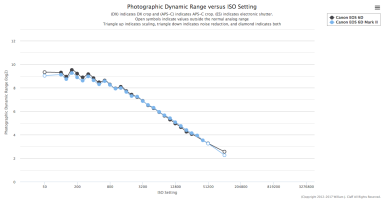

Bill Claff, care to comment? I can't help but notice the (e) for estimated has disappeared from your site, but it says it hasn't been updated in 8 days.
Is this your actual test data from a production camera? If final/official -- this would be a nail in the coffin on no on-chip ADC in the 6D2, would it not?
- A
Bill bases his analyses on RAW files captured by others, but taken according to his specifications. His estimated (e) curve for the 6DII was based on the random file(s) posted on the internet. He stated that DPR then provided him with RAW files to his specifications, which he analyzed, so the (e) is gone. DPR indicated they were provided with a preproduction camera, so it seems likely that Claff's 'final' analysis is based on RAW files from that preproduction unit. Perhaps Bill will comment.
