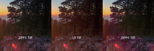

Here's my reasoning for this... I’ve noticed that the DPP software doesn’t convert to TIFF properly, basically when you use it for converting to TIFF and then import it into lightroom the blacks are crushed and muddied; here is an example from a photo that I shot on my 6D (cropped section of trees)
I exported a 16 bit TIFF (without corrections) from DPPv3, DPPv4 and lightroom; I then imported the TIFFS into lightroom and then set the shadows to +100%; as you can see the blacks in the DPP TIFFs are just mush but the blacks in the TIFF from lightroom have detail.
I've tried to attached a side by side example of my findings
So there’s hope yet for the 6DMKii

[...] so it's been rather disappointing to see the results of the initial tests, but I really don’t think that a proper analysis can be made until adobe provide RAW support.
Well, I haven't made any updates yet and haven't downloaded any 6DII raws ... But there should be proper support for the new RAW files in Lightroom and ACR according to:
http://www.canonrumors.com/adobe-lightroom-cc-2015-12-adds-support-for-canon-eos-6d-mark-ii-more/
So, best stop hoping. I think any results that we see now are pretty much the real deal.
BTW, is TIFF not incable to hold all the information from a RAW file anyway? At least I observed similar limitations when working in Photoshop with TIFFs exported from Lightoom.
Well, that is certainly a good point. I just don't want to get my hopes up again after having accepted that Canon did it's usual thing here and pushed things just as far as they need to be for average use. Which is fine, but takes away from the exitement of the camera in my opinion. I don't see Canon allowing so many RAWs and 6DII floating around if the production units were any different.
