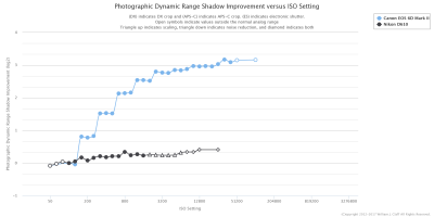

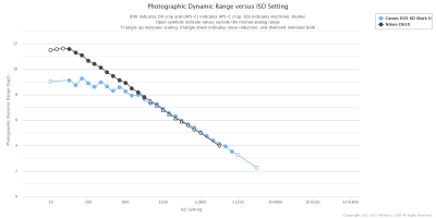

...Does dynamic range pair with iso invariant, or are these different?
Strictly speaking they are different ... but ISO Invariance shows up as a dynamic range curve that is more straight than curved.
So, often an ISO Invariant camera will also have a higher Photographic Dynamic Range (PDR) range at low ISO settings.
Note that in the corresponding Shadow Improvement chart more horizontal is more ISO Invariant.

Tom,
appreciate the response. I think I understand now. you are refering to shadow lifting / highlight recovery improvement in relatively low ISO 6D II file (ISO 200), according to the link you have provided. 6D II performs better in that regard due to less to no fixed patern noise, noticeable at low ISO settings. I was looking at HIGH ISO RAW files only. I would imaging that your "wildlife in rain forrest" shots will be in the high ISO range rather than low? this is my understanding of situation.
Ok. If so, then the "clean shadow lifting" of the 6D II would be of a lesser consequenses to the outcomes. and here is a very sharp explanation:

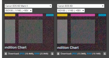

I took the liberty of comparing noise levels at ISO levels 800-6400 between 5D III, 6D, 5D IV and 6D II. images are attached.

OK, have a look at that DPR link, above in the quote, and, in the gallery, image 67; +1.65 push + shadow lift, etc.... zoom to 100% and that is NOT a nice result from a 200 iso raw file!
Lots of chroma noise and still looks like vertical banding FPN on the green railing.
Their processed jpg is here:
https://2.img-dpreview.com/files/p/TS3865x5153~sample_galleries/8212334571/0376770862.jpg
gallery image #28... chroma noise and vertical banding visible on the person's neck in shadow of iso100 shot.
#26, same again in the low midtones near the edges of the image, really shows up in the blurred tonal transistions
#24, more of the same in dark lifted areas and all over the sky
#22, iso 4000 shot, lifted... lots of FPN in the blue areas altho this could be NR'd out... shouldn't have to deal with FPN these days!

It's very surprising that the 6D mark II seems to perform even worse than the original 6D!
https://www.dpreview.com/articles/3416153698/canon-eos-6d-mark-ii-dynamic-range
1. +5EV is not a practical use case. I mean you can but you usually don't.... well, you should not :)
+3EV is a more reasonable use case to look at. I have posted the comparison image above but here it is again.
2. It seems strange that no one have noticed that 6D II image sharpness is better than the one of 6D, 5D III or 5D IV. look at the word " green" with little arrow undeneath (actually, right above), lines. it could be just due to image to image variation, but also could be due to reduced AA filter strength. Interesting...
