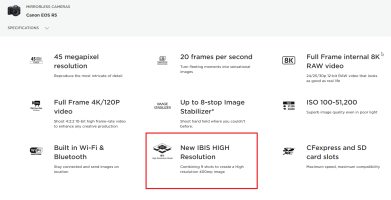

Are 400mp stills coming to the Canon EOS R5?

What would this feature be used for? Is it for printing large billboards of static subjects? I wonder how many Mega Bytes the RAW files will be. Since Canon are adding new features the R5 II must be quite some time away yet.
I would use it for rephotographing medium and large format negatives. In my current setup, I use a 5DSr, which yields about 2500 ppi for medium format, and only 1500 ppi for 4x5. For 35mm, this set up is fantastic, getting me about 5500ppi 'scans' which really captures all the info in the neg or slide. Getting medium and large format scans closer to that mark would be a significant improvement.

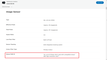

    Second, interesting point re IBIS being unavailable during this, but what about ILIS? Would it be safest to disable all stabilisation or the reverse?

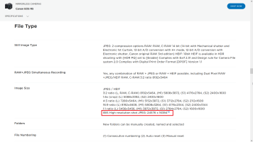

    There will probably be 2 options: in-camera compositing with output as JPEG/HEIF, or 9 individual (RAW) files that need to be composited on the computer. It's quite likely, IMO that both options will be available, but in-camera compositing with output as RAWs is extremely unlikely.
