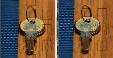

FWIW, here's an example of two successive shots taken of a static scene from a stable tripod, with a reasonably shallow DoF (135L @ f/2). Two focus attempts, two very different planes of focus. I superimposed the 7D's AF diagram (it's the whole AF sensor, but I sized the green 'x' to approximate the actual area of the center AF point). You can see that based on the AF point itself, both of the images are 'in focus' according to the parameters used by the AF system (green lines crossing a contrast boundary). The situation with the horizontal measuring tape is analogous, and that's why the reliable AF calibration tools all have a focus target that's parallel to the image sensor.
