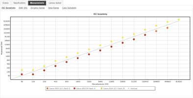

I am not an expert in how to interpret DxO scores. Does anyone know why the 1DX3 would score less than the 1DX2 (83 vs 88)? And even lower than the a9ii (93) and a7RIV (99)? I don't see how this makes sense.
Look at the measured ISO "sensitivities" at each setting. Either DxO's measurements are off, or Canon has decided to meter/expose everything about one stop to the right compared to everyone else (including previous Canon cameras), who tend to under amplify to protect highlights.

Oh that’s easy, DxO are incompetent and biased and take years to correct their obvious mistakes and even then don’t actually acknowledge making them.

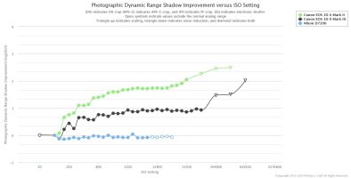

For another interpretation of DxO’s actual data just look here https://photonstophotos.net/Charts/PDR.htm it gives a very different point of view. The sensor on the MkIII is better than the MkII until you go into the highest iso numbers at which point the MkII RAW files are cooked and the MkIII files aren’t (the triangle).

According to photons to photos the 1DXIII has nearly flat ISO invariance above ISO 400 and is a significant improvement over the two previous IDX bodies. If you meter to protect the highlights you should be able to set the tone of the rest of the image to be pretty much anywhere you want without a noise penalty. Wasn't that the point? If that's not good enough I'm not really sure what you are looking for. As far as I'm concerned, Canon's DR is very competitive. CMOS sensors are never going to be able to capture the full range of available light in every possible scene. Develop a plan to deal with that and move on with your life. :)
Here is the 1DXiii vs the A9ii. The Sony's use two amplification ranges but other wise the results are very similar. This had been the area where Sony sensors visibly outperformed Canon's and now there is very little difference.

A.M.: ISO in-variance up to ISO 1600 is not? that's up to 4 stop strong push from ISO 100 that does NOT increase shadow noise. ok.. can I have that in 5 series Canon body please? :cool:

It's a very good sensor and an improvement over that in the 1DXII for iso performance. But, according to photonsphotos it is not ISO-invariant from 100-1600 iso but noise increases in a 100-1600 push. Very few sensors are ISO-invariant in that range, a rare one being that of the Nikon 7200.
