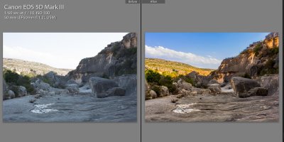

This video compares the D600 & 7D for shadow recovery and they also show a 5dIII file. It's clear to me that there is banding and grain in both the Canon shots more than the Nikon but only when viewed at 100% or more and only when pushing it all the way.
Nikon D600 Review Part 4 - Dynamic Range Testing...WOW!
I disagreed with a huge portion of this video. I understand where he was coming from but still I disagree with his approach. and the 5D mmiii scene was so different than the sunset scene there was no way to actually compare the difference. Although yes a huge difference between the D600 and 7D. I wonder what the difference is between the 7D and D7000 in this area.
