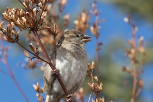

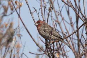

I shot both of these this week in my backyard using 7DMk.II + 1.4 Mk.II extender
with my first generation 100-400mm f-4.5/5.6L IS. The "birds" I usually photograph
are more often powered with jet/inline or radial engines and have at least one pilot
on-board! I however think that these show the potential for the setup you're considering.
Whatever your choice happy shooting. Edit I should have mentioned that these are NOT
crops simply converted from RAW to JPEG and sized to fit NO other post work was done
