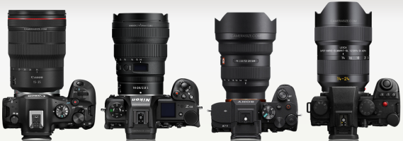

Am I the only one wishing for a 12-24 or 14-24 F2.8 ? I am also bothered by the 24-35 overlap and the 10-20 is almost too extreme and F4.
They have 7, 10, 14, 15, 15, 16, 16, 20 at various price points.. so if you're speaking of overlap....
Well, many of those are not f/2.8 and don't work as well as the 15-35 for astro. The 15-35 is excellent but harder to justify if already owning the 24-70 (to each their own). Each manufacturer (even Leica!!) has at least one bright UWA without too much overlap with the 24-70. Looking at the widest f/2.8 zooms in the industry (there is also the Sigma 14-24 for E and L mounts):
I would have expected a higher priority lens than the 10-20 f/4.
12-15mm.. doesn't matter whatsoever for astro. All 12 would do is add size and cost. The 15-35 is brilliant at 15, barely distortion. You can get them cheap, it's light. Who cares about an overlap between 24 to 35? That's strange.
