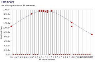

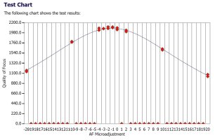

This isnt exactly a field comparison, but I ran a FOCAL test comparing these two TC's with a 500mm IS version I lens. Graphs are below. My tests (repeatable) showed that the version III was about 2-3% sharper then the version II. Hardly worth the cost with this older lens.
If you are pairing with a Version II supertele then the cost to upgrade is well worth it, not for the IQ, but rather the AF performance is far far superior with the III.
From strictly an IQ standpoint I don't personally believe it is worth it.
