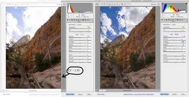

And? That's the level of shadow recovery you can expect. Nothing can make that less. If someone gets less that's not on the sensor.
Ok. Let's look at your sample (https://www.canonrumors.com/forum/i...y-a-lot-more-coming-in-2019.36985/post-771327) closer.
First of all, 5DIV is able to recover totally (visually) dark shadows, in your sample all shadows have detail before recovery. Second, why do you think you've recovered 3.5 stops? I've loaded your sample into PS and tried to match just the exposure of the shadows (see the attachment). I applied CameraRaw EV+2.55 to the left part:
183868
As you can see, the shadows are roughly matched and it's just 2.55 stops.
Where did I say that I recovered 3.5 stops?
I posted that image to make a point to the DRones on this board who miss no opportunity to say that the 5D4 and R sensors are old tech that are so far behind Sony on DR that we're going to switch brands any day now. I replied to a posting of a Panasonic S1 shadow recovery example by someone who kept talking about how great it was to have a "new competitive sensor" implying that the 5D4 sensor is old and uncompetitive.
A D850 / A73 / A7r3 / S1 score roughly 1ev higher than a 5D4 (give or take a fraction of a stop). The S1 scores 3.5ev higher than a 7D. With that kind of score and all the DR rhetoric that appears on this forum you would assume a vast visual difference in shadow recovery between a S1 and 7D. Yet the visual difference is relatively small. If that's what a 3.5 score difference equals in the real world, then a difference of 1 can't be seen outside of pixel peeping conditions.
If I had immediate access to a 5D4 at the moment I would fire off some shots tomorrow against a D800E to put an exclamation point on this. I can borrow the D800E any time I want but can't easily borrow a 5D4 for a few hours (at the moment).
Suffice it to say I've done these tests before between various camera pairs and have a very good idea of how those scores translate to real world prints and the sensors in the 5D4 and R are not behind. They are dual pixel architecture which costs them a point at DxO or PtoP but that doesn't translate to anything substantial in the real world. And if you really want to quibble about it, shoot DP RAWs and process them to add roughly 1ev on the highlight side putting those cameras on par with anything else out there, literally and to the numerical point score. Better even because most photographers would take 1-2 stops from the shadow side and put it on the highlight side if they could. It's the one lingering complaint from the film days since film by nature handles highlight roll off very well.
The "Canon sensor old" meme is old and boring.
BTW: the shadow push was roughly 2.5ev but there was also 0.5ev of highlight recovery. That was why I winked in the original post and said 'but I held the sky.'
Ok sorry I probably misunderstood you. You said that 3.5 stop difference between Canon 7D and Panasonic S1 isn't that big. I assumed you'd try and show a 3.5 stop recovery in 7D.
But again you shadow recovery sample above shows 2.5 stop recovery, and it's hard to check on the quality of the resulting image because it's too small. So it doesn't prove anything. You recovered 2.5 stops from shadows with dark but clearly visible details, and from this post https://www.canonrumors.com/forum/i...-more-coming-in-2019.36985/page-4#post-771313 we see a recovery from almost totally black shadows with no visible detail.
So I don't see, to be honest, how your example shows anything. The fact that you recovered 2.5 stops of shadowson an image from 7D doesn't tell us if the difference between 7D and S1 is insignificant. It doesn't even tell us if it's significant. It only shows you can recover 2.5 stops and it looks ok when downsized.
Ok, but again you example that uses 7D doesn't tell us anything about 5DIV vs S1 comparison.
