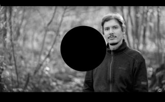

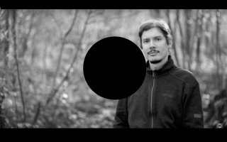

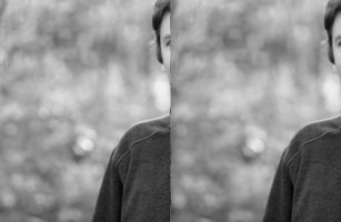

Just a little game, using Mirrorless Comparison's youtube review of the 50mm RF. I've selected their f1.2 and f1.4 samples, turned them to B&W and somewhat harmonised the brightness difference. Then I deliberately put a somewhat small dark circle in the centre of the frame. Now let's play. Which one if the f1.2 shot ? Which one if the f1.4 :D ?
185148
185149
So what is that small circle ? At this focusing distance this is the extent of the image area where you're going to see some difference between f1.2 and f1.4 on the 50mm RF. And note that the above shot is a 16:9 crop for a youtube video, so it's even less of the total area for a 3:2 picture. And even then I don't think that there's a lot of room to pretend that this small difference is going to make the shot - certainly not compared to other areas of bokeh performance.
185150
At short - very short - focusing distances it seems to me that the 50 RF has less vignetting so you may see more tangible benefits to the aperture. But at portrait focusing distances its f1.2 physical aperture is rendered nearly useless by the vignetting.
Also the final sample image (antelope or bighorn sheep grazing in a field) is underexposed and IMO a bad photo - certainly they could have used a better nature photo?
