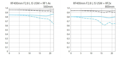

The MFT chart measuring and reporting methodology was updated and aligned before the MK II tele's were introduced. So they are directly comparable. Canon have updated some of the older EF lenses using the new MFT charts (such as the EF 135mm f2.0 L). The RF teleconverters are showing an uneven sharpness across the frame, sharpness wise in the centre, there's not a lot between them.
Here's the 1.4x TC taken from the Canon website:
1729728034061.png Here's the 2x: 1729728126580.png
Both sets of charts are using the same optical formula, the EF 400mm f2.8 LI S III and the RF 400mm f2.8 LIS. The only difference here is the teleconverters.
The RF teleconverter MFT charts are quite hard to find now, I suspect Canon are aware of this comparison and are now hiding the RF teleconverter charts from their website.
