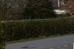

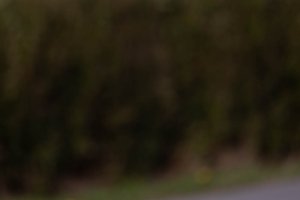

I have attached a couple of unprocessed images as examples to see the issues I’m having.
Taken with a 500mm F4 IS ii with 1.4 ex iii and canon adapter, shot in fully manual mode (no auto iso).
The first image of the roe was taken from around 30m from behind cover. It was 30min before sunrise under exposed to prevent pushing the iso higher.
The deer was very still trying to look for me. I was easily able to put the centre focus point on his eye- easy shot. The camera has decided to focus on the reeds behind him and this was the same in every shot. I have taken the same shot with my 5D4 countless times and never had this issue.
these deer are very camouflaged against usual bushes an brambles and they are hard to spot. I could maybe understand it then, but with the light reeds behind why would the camera get confused? Even with its contrast based AF system?
The noise at ISO 4000 is also incredible! Reminds me of my 7Dmkii.

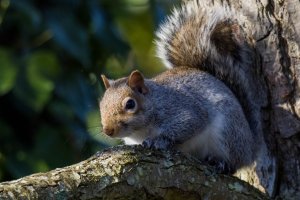

The second image of a squirrel (30min after sunrise) was the only image where the eye detection was keen to lock onto his eye and hold it. To me it looks like the branch just in front of his nose is the focus point though?

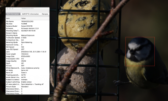

I have checked in DPP and it appears that the camera picked the right spots, but the lens isn't on the same page.

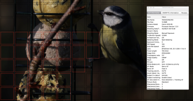

The R5 came with firmware 1.1.1 installed and it was the same. I thought updating it to 1.2.0 it would be much better, sadly not.
Here is another example - single point focus which I placed squarely on the deer's face.
You can see in the 100% crop that the image is so so soft! Its like that my keeper rate has reversed, so the images I would have missed are now my accidental keepers.
It looks to me that the AF is working overtime giving the fuzzy look but turning it off doesn't seem to make a difference.
Another strange thing I noticed, the IS option in the Menu disappears when you attach an EF lens with AF. Whereas everything else that is unavailable (for whatever reason) is greyed out, so why is this not just greyed out? Why does it disappear completely?
What angers is me is knowing had I taken the 5D4 these images would be perfect. Its not like you get close to these animals very often so to have such lovely light and proximity ruined by the R5 is not cool at all.
It says you are using one shot AF. From what I have seen reported about the R5, you really want to use servo AF all the time.
Just to be sure, what type of battey are you using? I doubt that's an issue, I'm just curious.
Using servo to keep the AF engaged should be something worth investigating if you previously used one shot on DSLR.
Also, as I said, if you are concerned with noise, do NOT underexpose your images.
Maybe also worth asking: Do you have the eye AF priority set to animals? Might want to do that to ensure proper subject detection even if it apparently also works in the other modes.

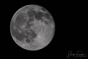

I have just tried another go at the moon this eve.
I turned off the In-Body stabilisation and turned on the Lens Drive when AF Impossible. I took a selection of shots, some with single AF point on single shot, then servo then switched to AF-Face detection (no priority) in single point and servo af.
The images produced varied results, the best was the Face detection in servo mode, which goes against everything you would believe for a static (albeit travelling at 2300mph at 250m away) subject in the sky. Having done tons of moon shots with the 5D4 it always performed best with single point, single shot.
So the best shot out of the R5 to date is the moon!

i'm quite sure the camera has a AF issu, it seems "blind" most of the time, never happens to me with other. here are 2 photo, one at 500mm with the 100-500mm RF, impossible to focus on the bush, when i come back to 100mm, the camera did not acquire focus anywhere on the background, had to point at the left to get focus and then i could focus on the background. servo, point , 1/4000s, iso 1000, f7.1, if this is "normal" for the R5, i sell it right away...
Back to the subject in hand - playing with AF settings today and again the images appear to be back focused.
The Blue tit with the focus point nailed on his head is out of focus, whereas the fat ball behind him is crystal clear.
Second pic shoes a missed focal point, having picked the front of the feeder, but the bird is now clear in focus.
Again, like I was saying, the R5 appears to only result in keepers wen the AF gets it wrong.
