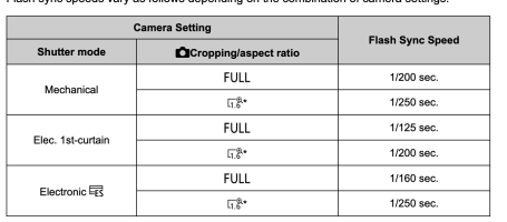

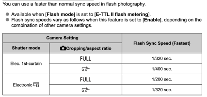

Based on the icon, this looks like a flash sync increase when you are in 1.6x APSC crop mode only?The R5II manual shows a "Sync Speed Priority" setting that boosts the sync speed in EFCS to 1/320s and ES to 1/200s:
The flash sync speed increases in APS-C crop, yes, but you need to compare the numbers in the table above to the numbers in this table:Based on the icon, this looks like a flash sync increase when you are in 1.6x APSC crop mode only?
Ahh that makes sense, sorry I missed that.The flash sync speed increases in APS-C crop, yes, but you need to compare the numbers in the table above to the numbers in this table:
So ES goes from 1/160s to 1/200s sync speed when using the full sensor. EFCS goes from 1/125s to 1/320s, a much larger increase (or rather, decrease).
The tables are in different sections of the manual :/

I wonder if the R1 will have a similar setting, and if that accounts for the discrepancies in the information where some sites listed 1/320 s and some listed 1/400 s.The R5II manual shows a "Sync Speed Priority" setting that boosts the sync speed in EFCS to 1/320s and ES to 1/200s:
The only thing the manual remarks is that this is an EL/EX feature, so it likely doesn’t work with my godox v860c.Ahh that makes sense, sorry I missed that.
I wonder why this is a separate mode and if there are any compromises?
