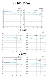

I suddenly understood that you can achieve 600 and 700 mm both with the RF 100-500 mm equipped with the 1.4X TC and the 2.0X TC.
Has anyone out there compared the results for each one of these focal length combinations?
Which one gave the sharpest pictures? Which combination gave the best contrast?
Differences that should seriously be taken into consideration?
According to Canon's MTF charts, the 1.4x is sharper and more contrasty at both.

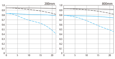

Canon MTF charts also suggest the 200-800 will have slightly better sharpness and virtually identical contrast at 800mm as the 100-500 with 1.4x at 700mm. More testing is needed to find where statistical reality lies (given sample variation), but in any case, the lens performance looks very close, with the 200-800 having an extra 100mm and 1/3 stop advantage, which may give it a slight edge for those working near the practical limits of ISO.
