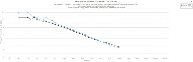

If a movie camera can have 16+ stops of dynamic range, why can't a still camera? OTOH, I haven't seen much these days in the info about the R5 / R6 as to what their dynamic range is. What's with that?
There has been a large improvement in DR with the R5 sensor. Here is a graph that compares the R to the R5.
