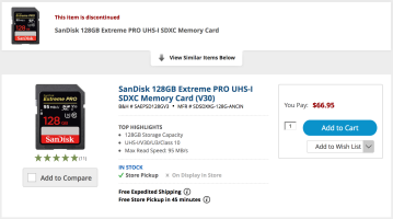

tron said:
Here is the sandisk link for compatibility check for 4D4
http://pct1.sandisk.com/ProductList.aspx?DeviceID=22974
The new V30 cards are not listed!
Speaking with B&H, they stated that the Sandisk list had not been updated in quite some time. In fact, I cannot find a V30 card recommended for ANY product on their list.
B&H also said the SDSDXXG-128G-ANCIN was a direct replacement for SDSDXP-128G-A46, which is no longer being manufactured or sold. Without explicitly saying so, this was supposed to just be a re-label and they are being sold along with the 5D4 in packages.
Is it complete BS on their part just to sell more cards? Who knows...
