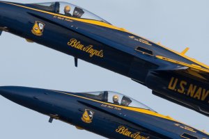

Even if the IQ was exactly the same, the 70-200 + TC is an extremely cumbersome combination, as Neuro stated. I lugged it all day at a recent airshow, mostly pointing it upwards, and my arms were sore... :(
I do love the photos out of it, but then I am not a professional, and my standards are certainly lower than those using the great whites (and yours, most likely). The one below was shot with the combination at the airshow mentioned above, cropped 1:1 from the shot below it. I am happy with this level of IQ and resolution.

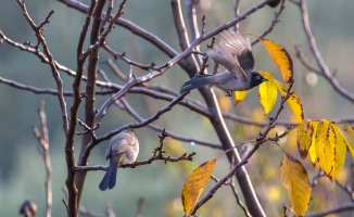

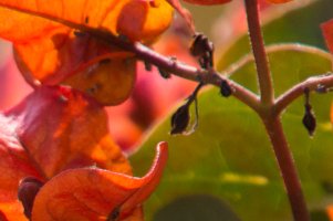

I got the 70-200 f/2.8 IS II yesterday along with a 2xTC II(the 2xTC III should be better), below is a test shot(just to show the performance) with the center and corner crops respectively:
400mm f/8.0 1/500 ISO400 (no PP only the default LR sharpness of 25 applied)

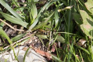

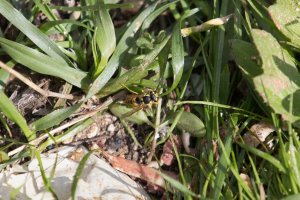

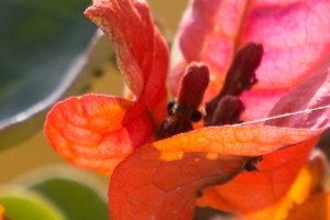

I did some more today, tbh i am not sure if its me, the lens or the camera, but i think there is an AF problem, anyway these are the best 2 out of 8, you will find each and a crop of the center below, all raw converted to JPEG with LR :
1. 350mm f/8.0 1/1250 ISO640
2. 342mm f/8.0 1/1250 ISO640
Looks like a combination of backfocus (did you check for afma?) and motion blur to me. Getting an insect like this in focus with a tele lens is very difficult, and the result with a tc won't overwhelm you in any case. If you are interested in these scenes, think about getting a macro lens like the 100L or 180L (for more reach).
meywd said:
To compare, here is one without the 2X TC II:
Maybe or lens shake (did you wait a moment to let ths IS swing in?), or motion blur - 1/500s is not that fast on 200mm * 1,6x crop. But generally this is about what you get after heavy cropping like this, remember your crop sensor already uses only part of the lens' glass.

i think there is some back focus, but i am using the 600D so no AFMA, motion blur maybe both are moving fast, i had the 100mm non L macro its a great lens, but i switched it for the 20-700 f2.8 IS II - along with other lenses - maybe will get the 100L or 180L later, i was searching for birds and found this fella near my feet.
as for lens shake, i found out that @ 1250 IS was working against me, the bird shot was with IS on, but the insect was with IS off, you are right about the speed and cropping, i only did this for a quality test, i don't see a huge difference in IQ, yes there is difference, but i see the 2x TC II usable with the 70-200 f2.8 IS II, and maybe on the 5D III it will be better.

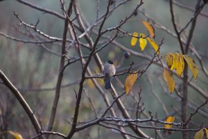

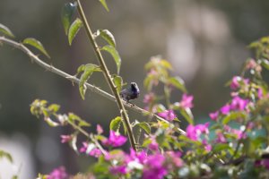

Here is one taken with the 5D III w/ 70-200 2.8 IS II + 2xTC II, import and export with no changes
Ugh. That's about why I stopped "birding" with my inadequate gear, in lower light and/or when the animal is far away as the results have a distinctive "90s mobile phone" look to them :-\ ... it's important never to tell that this was made using €5000+ gear :-p

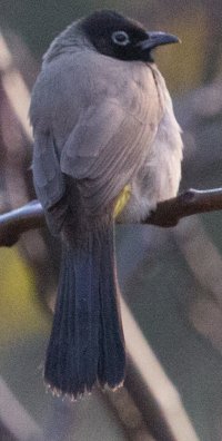

hahahaha you are right, a 600mm f/4 would be great, but still i was hand-holding it and that's why i went to the 1/2000 shutter speed, plus i am not skilled enough to track the bird and was afraid it will fly away immediately, if i was setting and waiting i would have used 1/400-1/600 which would allow a lower ISO, and if i was hiding the bird would be closer to me, anyway i am still starting so though it might not be great i still like what i get, this one with same settings but edited, the flying one was not the one tracked so he is not in focus, but if i didn't have 1/2000 he would be blurry.

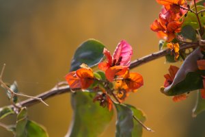

Yeah and 1/2000 is only the starting point >:( , at least with better light the pictures are not bad, until i get a dream lens
260mm 1/2000 f/5.6 ISO 1000, cropped and processed
