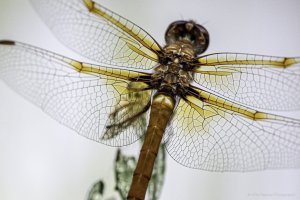

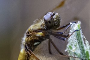

Just one remark and hint if wanted:
The background on pic one is quite nervous and noisy, either from high ISO or too much sharpening.
First one cannot be avoided if light is too bad, but try to avoid oversharpening.
Thanks. But, I didn't sharpen anything other than what I already have set up in camera; usually +1 or +2. I probably uped the clarity, so that could be it. I used the 100 macro and 5dsr. The dragonfly wasn't spooked by my presence for some reason, but was not in a good position for me.
... I didn't sharpen anything other than what I already have set up in camera; usually +1 or +2. I probably uped the clarity, so that could be it. I used the 100 macro and 5dsr. The dragonfly wasn't spooked by my presence for some reason, but was not in a good position for me.
I am sure you didn't if you say so. Maybe just share the EXIF data.
When I look at the pic and the BG I would suppose that this pic was taken at ISO 3200 (at least > ISO 2000). If so then it was reason #1 (too high ISO) and not PP.
And I surely didn't want to offend you but just help you to improve an already very good pic.
You haven't offended me. It was high ISO, 4000 with light fading fast. The 5DSR is not the greatest with high ISO's. I still only managed 1/100, which in my old hands is approaching my limit! I could have opened it up more as I used f5.6 for better dof. That was where I could have improved it and auto ISO with it.
