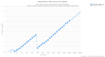

I have several objective tools at my disposal to make these decisions but as I indicated earlier it's hard to quantify the amount of signal processing (noise reduction) that is being applied. Ultimately the assignment of the down triangle symbol is a judgement call and I try not us use the symbol which is why the R3 results were delayed as I double-checked.
Regarding the Sony ILCE-7SM3 it's useful to look at the attached Read Noise as a function of ISO setting.
I decided that the drop above ISO 102400 warranted being labeled as noise reduction.
I see no evidence of anything at ISO 12800. There's a slight drop at ISO 4000 that I didn't deem significant.
